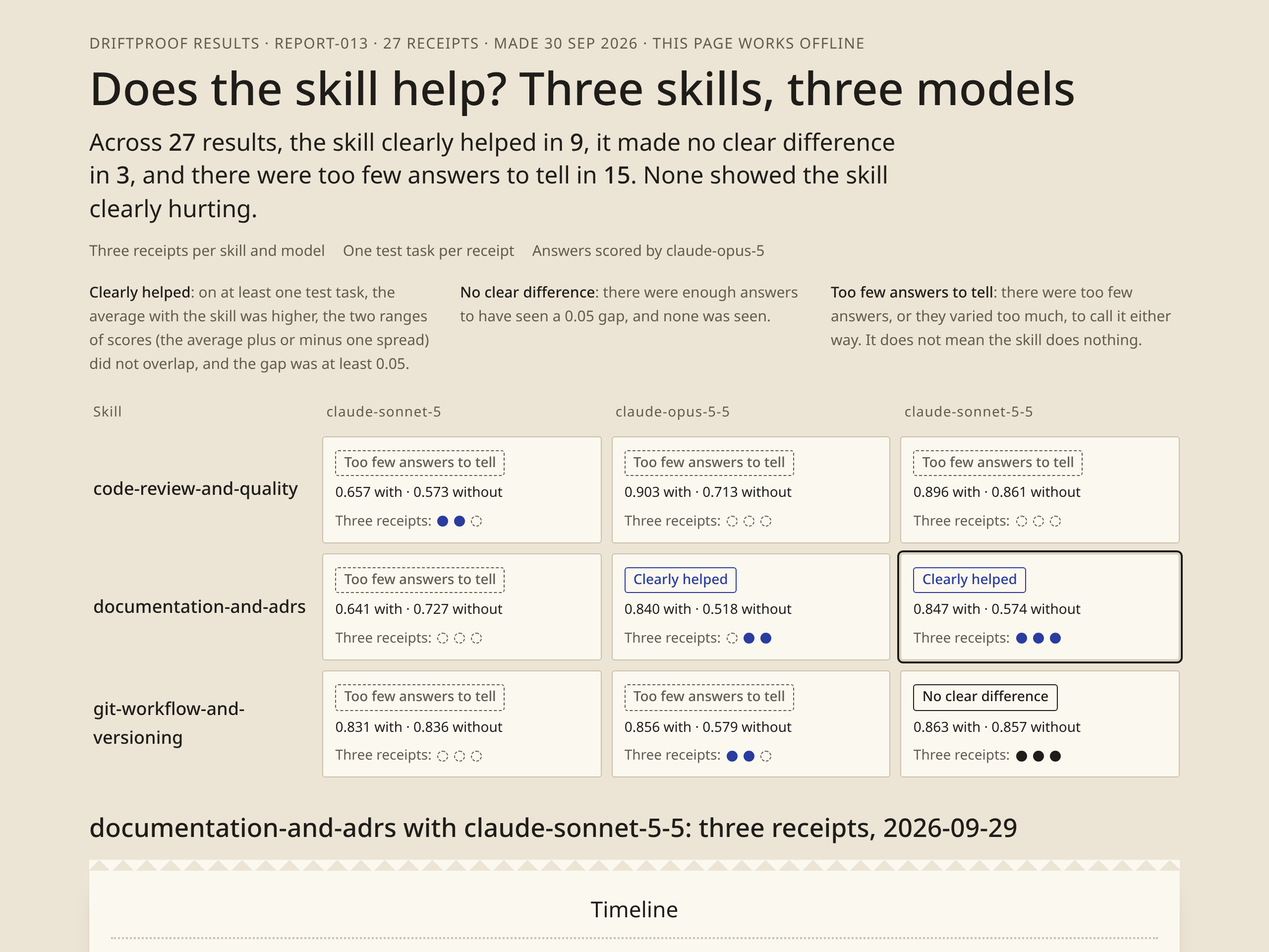

Latest finding · Report 013, 29 Sep 2026: with the skill, Sonnet 5.5 was never clearly higher or lower than Opus 5.5 in nine results (three tasks, three repeats); five of the nine had too few answers to tell.
driftproof live badge for the bundled example, generated from its own receipt.
All twelve reports · driftproofhq.com
The page driftproof view makes from Report 013's receipts: three skills by three models, each result in plain words: clearly helped, no clear difference, or too few answers to tell. The page npx driftproof view makes from Report 013's receipts, in one file that opens from disk.

Twelve reports are published, spanning seven report types. A report page lives at a draft path — docs/reports/NNN-draft/ — until the publish sequence renames it, and scripts/build-public.sh excludes every *-draft/ path from the published tree (see the roll below, and REPORT-STYLE.md for the shared chrome every report inherits). Each report and every verdict in it are re-derived from the receipts committed under receipts/ (receipts/report-001/ … receipts/report-006/) — nothing is hand-entered. Report #010 takes no Driftproof measurement and has no receipts: it is re-derived from the upstream harness's output files, published beside its page.
📊 Twelve published reports (each re-derived from committed files, nothing hand-entered: Driftproof's receipts, or for Report #010 the upstream harness's own output), spanning seven published report types, the newest being instrument comparison. The eleven that measure with Driftproof read its own arms by one band-based, floor-gated verdict rule and differ in what moves underneath the skill — or, in the value report, in which axes are measured; or, in the instrument re-measurement, in the instrument itself; or, in the instrument comparison, in which instrument measures:
  • Report #001 — release drift: ten public agent skills across a current-vs-previous Sonnet release; 9 of 10 showed a separation detected under the rule. (markdown)
  • Report #002 — substrate durability: the same suites across two vendors' CLIs (Claude vs Codex); 3 durable, 4 substrate-dependent, 2 regressed, 1 no effect.
  • Report #003 — release drift: claude-opus-4-8 → claude-opus-5; 4 improved, 2 regressed, 4 with no separation detected.
  • Report #004 — capability gap: claude-opus-5 (flagship) vs claude-fable-5 (frontier tier); 3 durable, 5 tier-dependent, 0 regressions, 2 no effect — encoded expertise survives the frontier tier.
  • Report #005 — value: what a skill costs to run, on three axes (accuracy, cost, latency); the same ten suites on three substrates (claude-sonnet-5, claude-fable-5, gpt-5.6-sol) — 14 of 30 cells cleared the floor on aggregate: 10 carry a price and 4 report a saving instead, having improved quality while reducing cost. Three of those cells carry an amendment (v1.1, applied when Report #006 published): their lifts rest on single-draw baselines since shown unstable. Cause-agnostic, no corrected figures offered, and the cost-driver and substrate-disagreement findings below are unaffected.
  • Report #006 — revision drift: the pinned skill revision against the one upstream ships today, on a held substrate. The reuse premise was tested and refused: 3 of 3 cells returned no verdict, each blocked by its own baseline control. A 120-call probe found generation-level sampling noise 3.2× and 7.5× larger than the judge-level noise this instrument actually samples — enough to account for every gap the controls saw without any other cause being established — and the receipt spec gains generation sampling as a result. No cause is asserted; the control proves non-reproduction and cannot say why. The tally a refusal carries: 3 cells, 0 measured, 3 refused.
  • Report #007 — instrument re-measurement: the three cells Report #005 published for these skills, run again with the generation sampled adaptively instead of once and with the call timeout the surface policy declares. No cell separates: every lift is smaller than its own band, and the 21 cases read 3 improved, 0 regressed, 18 no effect, 0 not measured. Five of six comparisons against the archive were refused on their baseline control. The instrument defect it reports is its own: a declared 300 s timeout had been shadowed by a 120000 literal since 2026-07-27, and the truncated run it caused measured less variance than the clean re-run, which is the direction that flatters an instrument. Both runs are published, the broken one as evidence. Amends #005 to v1.2 and #006 to v1.1.
  • Report #008 — release drift: two of Report #007's cells re-measured on claude-fable-5-1 against claude-fable-5, with the skill content_hash and suite_hash asserted identical before the first call. Neither cell showed a separation detected under the rule: the 14 cases read 0 improved, 0 regressed, 14 with no separation detected, 0 not measured, which is not evidence that nothing changed. The first release pair in this project where both sides are generation-sampled receipts, which is what makes the delta attributable to the model rather than to the instrument. One case sits inside the verdict on the effect floor alone and the report names it.
  • Report #009 — instrument comparison: three skills from one plugin, one case each, measured by Claude Code's native plugin eval and by Driftproof on the same SKILL.md bytes, task prompts and rubrics. The two tools apply different treatments and grade differently, so the report reads them side by side, ranks neither, and states what each can and cannot establish. Both tools judged with claude-opus-5, which departs from the judge policy, so its figures are not comparable with Reports #001 to #008.
  • Report #010 — instrument comparison: one skill's own behavioural eval from its upstream repository, run five times under each of two Claude Code configurations at one commit: 8 passed and 2 failed, both failures on one expectation the skill's ADR instructions do not state. No Driftproof measurement was taken and no Driftproof judge ran, and the report does not isolate what caused the variation.
  • Report #011 — release drift: Claude Opus 5.5 on its release day, measured on Report #009's three skills and cases, one case each, beside a fresh Claude Opus 5 arm on the same Claude Code version. Read by the runner's own comparison of the with-skill arms, the three skills read 1 with no separation detected and 2 with not enough draws to conclude at the effect floor, which is not evidence that nothing changed. A second table sets Report #009's own Claude Opus 5 receipts beside this run's; between them the Claude Code version, its host build and the date all changed. Every draw was judged with claude-opus-5, which departs from the judge policy, so its figures are not comparable with Reports #001 to #008.
  • Report #013: release drift, Claude Sonnet 5.5 the day after its release, measured on Report #009's three skills and cases, one case each, beside fresh Claude Sonnet 5 and Claude Opus 5.5 arms on one Claude Code version, every arm run three times. Read by the runner's own comparison of the with-skill arms, Claude Sonnet 5 against Claude Sonnet 5.5 across the three runs reads 2 separated upward, 3 with no separation detected and 4 with not enough draws to conclude at the effect floor, which is not evidence that nothing changed. Beside Claude Opus 5.5, the rule separates Claude Sonnet 5.5 on no skill in any run, nine results in all, and five of those nine had too few answers to tell. Every draw was judged with claude-opus-5, which departs from the judge policy; its figures compare with Reports #009 and #011, not with Reports #001 to #008.
✍️ The launch essay, Three model releases later: what actually happens to agent skills, reads all twelve reports together: what moves underneath a skill, what the skill costs to run, and what a corrected instrument did to three published results. Revised 2026-09-29; every figure in it is gate-checked against the report page it cites.
